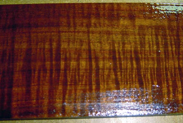

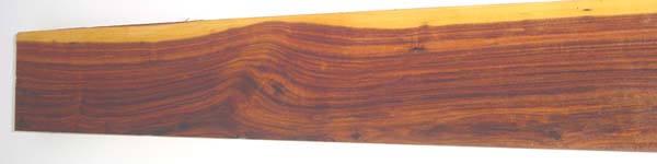

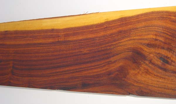

Anyhow, yesterday evening I resawed a small log of Mulga (Acacia Aneura) attached is a couple of images of one of the fretboards I converted out of the smallish round that I had. This piece has been shellacked to show figure. Not only is it just as dense as Coco, it even looks like Coco, what do you reckon, do you like the sap?
Probably not the same intensity of ink lines as Cocobolo, at least not in this bit, but it still looks pretty and it rings like a piece of plate glass. Also, because moisture is low, even when green, this stuff is very stable as a rule.

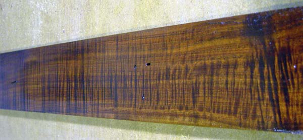

And below are a couple more images. These are of another fretboard that I cut this evening from a billet of a different kind of Acacia. I think that this one is known as Acacia Minirichi, but I can't be sure. The billet was very old and given to me as an unidentified dressed piece of wood but it sure looks like Minirichi to me. Once again shellac was used to pop the figure.
Unfortunately, this bit has a few worm holes, but with figure like this, it will we worth breaking out the epoxy. This stuff is not as dense as the Mulga pictured above, but it still a very hard wood and it taps very nice.
I cut a few fillets of this Minirichi a little thicker from which I intend to make bridge blanks, it seems to weigh in similar to BRW and has a similar feel, if that makes sense, anyhow it will be interesting playing around with this stuff.

Paul, the colouring in the images is not very good, I have a piece of Western Mayall and this stuff is very similar but the Mayall is more of a maroon chocolate were as this stuff is more chocolate maroon if that makes sense. I also have a piece of Minirichi I got from Tim a while back and it looks to be a very close match with this stuff, it even has very similar figure.
What ever it be, it is good wood. I was told it was cut maybe 30 or 40 years ago, so I will use it with pride what ever it is. One thing I can tell you, the images above really do not do this wood justice, it is quite spectacular in the flesh and I will gladly take it holes and all.
